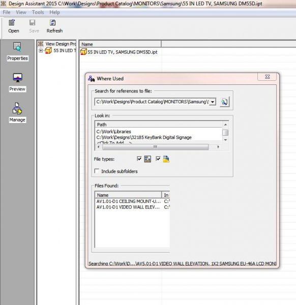

Is there any way to see where parts and/or assemblies are referenced by a drawing , and if yes , to see this drawings names , location etc...
Thanks

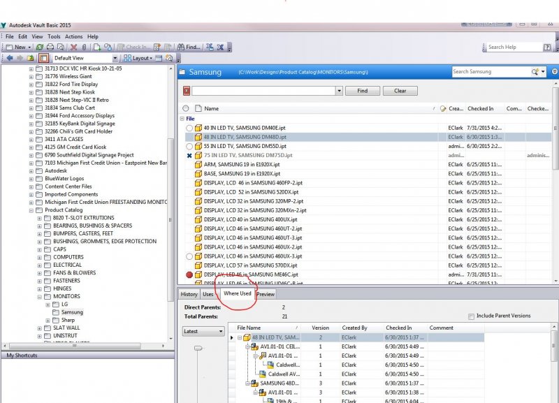

You can use Design Assistant. In the menu select Tools - Find - Where Used. Browse to your part/assembly file in Search for references to file: Add the paths you want to search under Look in:. Or if you are using Vault, select a file in Vault, and select the Where Used tab.

Vault is the preferred method and if you go over to the Labs website they have a number of plugin's that can do it. I have not come across a free one that works well. As for Ilogic or VB I have not seen anything using these two methods doing what you want them to do.
Vault is for multi users projects?
dont know what is it actually ..
Yes its used for multi users and projects. It does what you want above and a whole lot more. Very powerful data management software. I may have a few watered down version when you purchased Inventor and you can upgrade to the full version. To use it correctly you would need a days training as it can be quite difficult to understand by teaching yourself.
Ok got it , but if im not working with multi users , is there any use for it ?
Other than finding and linking files and renaming files etc (makes it easy inside fault) then it would not be worth it.
