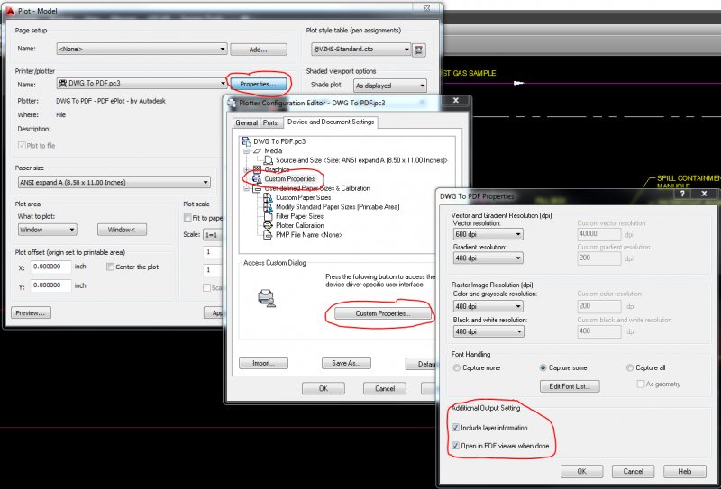

MAREBER Posted August 14, 2015 Posted August 14, 2015 Hello again, I normally plot to 'DWG to PDF.pc3'. I have not had issues in the past with layers also being plotted with PDFs, but my old PC died and I am now on a new PC that is outputting PDFs with layers. I have tried going into CAD properties and also Adobe properties with no luck as of yet. This is one of a few glitches that I am trying to figure out. So any advice would be lovely. Also, while I am on the PDF subject, I would like the plotted PDF to open automatically. Can someone help me to find that adjustment as well? THANKS! Quote

RobDraw Posted August 17, 2015 Posted August 17, 2015 Since you did not mention anything about publishing, I'm not sure why these guys would mention it as a solution to your question. The settings you are looking for are located in the printer settings as shown below: Quote

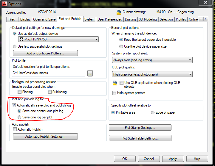

MAREBER Posted August 17, 2015 Author Posted August 17, 2015 Thank you so much! That took care of the auto layers issue. Although even though checked, as shown above, the PDF will not open automatically. One more question, how can I stop the creation of a plot log with every plot? Quote
MAREBER Posted August 17, 2015 Author Posted August 17, 2015 Thank you Rob. I unchecked that and it is working now. PDFs created with the plots are still not opening automatically though. I must be missing something? Quote
RobDraw Posted August 17, 2015 Posted August 17, 2015 Yeah, not sure about that one. I don't really have time to play with it. Maybe someone else can chime in on that. Quote
