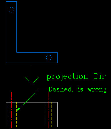

Hello,
I've been learning about lisps for the three month .
I have a idea , and completed 90% , I met difficult problem .

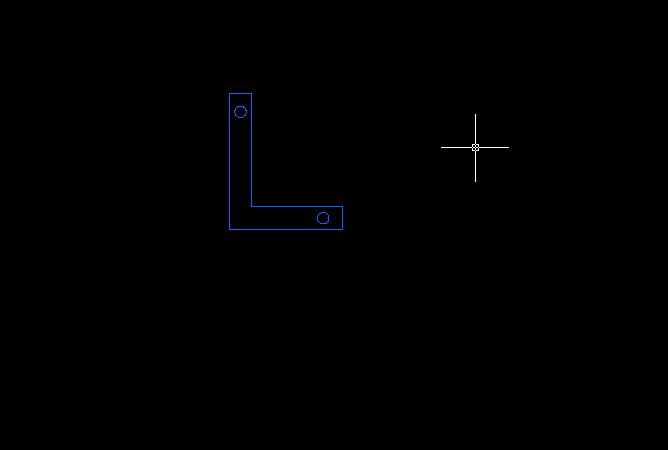

Here is a Demo
Problem

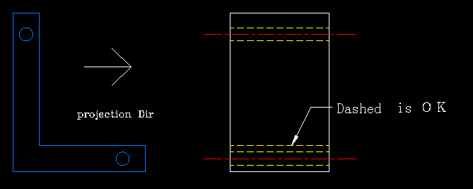

Invisible Line is Dashed , OK, No problem.
Visible line must be Continuous , not Dashed .

Projection.lsp
Either both should be dashed, or both should be continuous, or something third... You are projecting right side viewed from left so according to you dash is OK on the first picture and then you are doing projection down side viewed from top so that edge is visible... You should take some kind of standard of projection - that is fine if you are doing it like it's shown on animated gif, but then you should consider visibility problems... And are you always projecting simple geometric shapes like that... If that's the case then consider entmaking bounding box rectangle and find intersection between it an shape... With your way of projection if points - intersections between bonding box and shape are on left/up edge of bounding box then projecting line should be continuous and opposite if on right/down edge then it should be dashed... Points that don't intersect with bounding box rectangle are always dashed... So when building point lists for projecting make elements of lists ((x y z) "cont") or ((x y z) "dash") so that you can obtain correct (cadr listelement) key according to which routine should determine what type of line layer should be used during entmake line entities...
@marko_ribar
Thanks for your reply . Seemingly very complex and beyond my ability.
If anyone is interested, Please help me modify it . Thanks.
