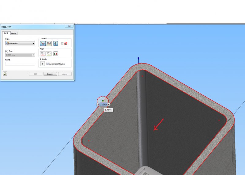

How do i select the middle point of this profile while using the joint command ,it shows me the pointbut if ill try to move to the center it disappear immediately

Hold the CTRL key down when you are on the object you want. This will filter the selection to only that object and will not jump around.
Ctrl is holded , im still unable to choose the center point of this profile
I'm not having any trouble with it on my end. What version of Inventor are you using? I know 2014 the Joint command was a little rough yet. In 2016 I can select the profile just fine and they even opened it up to allow to connect to Sketch objects. You might try adding a sketched point at the center if you are using a newer version and having trouble selecting it.

First ive changed the selection filters to "Select Faces And Edges" Then i was able to see the center point very fast and now when im holding ctrl , its working very well:D
