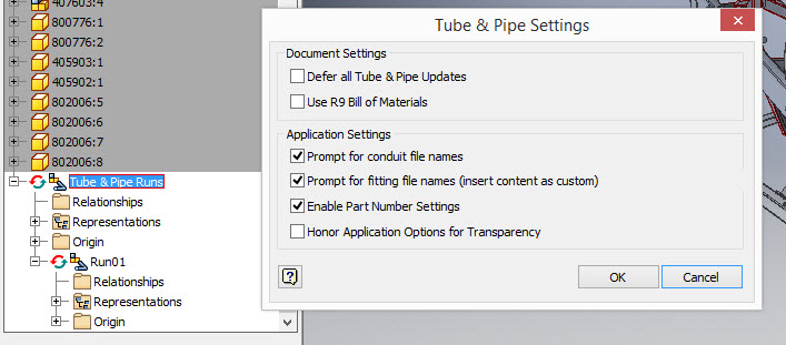

i chooses in the "application option" to bring parts from content center as custom . is there a way to make sure they really are "Custom" , because it seems that inventor isn't really make all parts as custom (i believe it has a bug )

btw, the Custom option only creates the custom file in your local workspace when it is a custom family like a piece of pipe or structural steel, the default fittings in your runs will go to the content center files folder that is stored outside your local workspace.

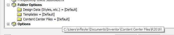

In your project file what the project file say for content center files...see attached.
You could copy these files to your dropbox and change this setting to match your application options if it does not already. Typically the project file trumps your application options so if it was defined here already as something else that may still cause conflicts.
Also in 2016 you can now prompt for Custom Fittings now too.

In both PC'S folder option is set to the same path at my Dropbox, and still many components came from content center are missing, (I'm using 2015)
