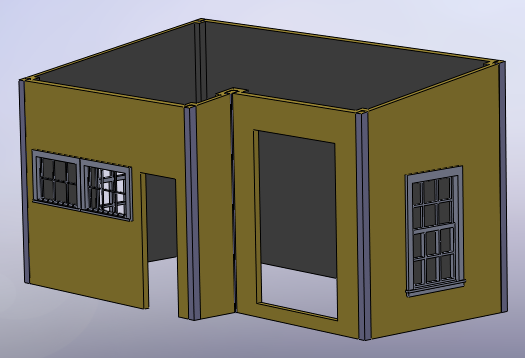

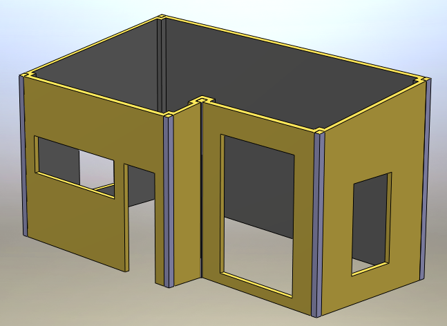

This is what I did, I'm just playing with SW so I decided to create a small building (I know SW is not really designed for that - but anyway).
I created an extrude of a closed sketch representing the outline of the walls. Then instead of using shell I decided to use thin in the extrude.
Now I wanted to add clapboard siding, so I created a sketch for one board on one wall, copied the sketch to the other walls, then did an extruded cut, then used array to copy the board the entire height of the walls.
Now when I had the solid with the thin I decided to change it to a solid and shell instead, but SW wouldn't let me remove then 'thin' from the feature, so I ended up deleting the feature and add it again, and with no problems in creating the solid. However, now all the clapboard sketches are missing their planes since all the original faces had been deleted. And it was now when I tried to select the "Select Plane" on the sketch that the main extrude (the walls) disappeared, and reappeared as soon as I exited the 'plane' command.
This is what I'm playing with. I'm only using this for practice, which is the reason I decoded to create the building as a single part (multipel bodies), including all walls and trim.
The second image is the assembly where I'm now working on the windows and door
