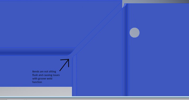

I am using Inventor 2016 and have four separate parts each with a dual bend that has a 45 degree chamfer on it. Due to the bend profile it does not allow my angle make a smooth constraint. Is there a way to clean up the bend edge so that the two parts meet flush or is that function sort of a pipe dream
Has this model been done all within sheetmetal? How did you model the 45 degree mitre as this is what looks to be the issue. If you had included a picture of the history tree it will help with building a picture of how you modelled it.
