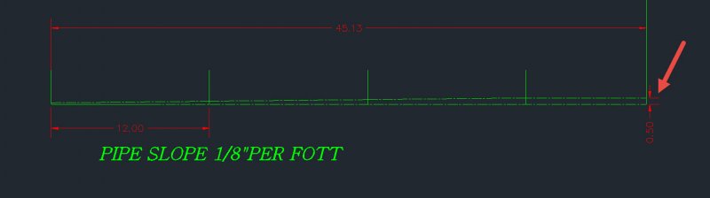

Can someone educate me some more about slope, i want 1/8" per foot slope, the total run is odd number 45.13" and i end up getting total slope of 0.5" in autocad, does it look correct? I calculated on paper i got .470" (not too critical). i just want to have accurate on CAD. thanks
Your calculation is correct and AutoCAD should reflect that. The image appears to show that the endpoints to the left are not coincidental.
Ok, thank you, it is not coincidental because i have not draw the slope line from the end point to end point yet, the line shown 1/8" change ever foot. thank you Robdraw.
