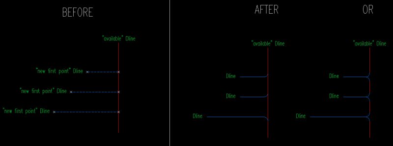

hkncdrc Posted September 3, 2015 Posted September 3, 2015 Hi Friends, Help me, Please... long time ; It is taking a long time to one by one. Dline, Break, Fillet, ............................ Break Quote

hkncdrc Posted September 3, 2015 Author Posted September 3, 2015 What is a dline? hi lee, sorry it is written wrong DLINE actually LINE Quote

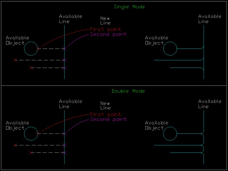

hkncdrc Posted September 4, 2015 Author Posted September 4, 2015 Here, experiment with code posted here :http://www.cadtutor.net/forum/showthread.php?92378-one-line-to-many-fillet&p=#3 And also my modified version for double fillet + trim main line posted in attachment... Regards, M.R. HTH. Hi, M.R. Thank you very much, for your attention LISP start single or double ? fillet radius? LINE first point (object or gap to draw the line to start) LINE second point (available on line over the click) My english is not good Quote
marko_ribar Posted September 4, 2015 Posted September 4, 2015 No, no clicks on lines, just select them all, pick or specify radius for fillet and move mouse around the screen (previously selected lines must cross or touch main line) and that's it... When satisfied with result just click with mouse to accept. Quote
hkncdrc Posted September 4, 2015 Author Posted September 4, 2015 (edited) No, no clicks on lines, just select them all, pick or specify radius for fillet and move mouse around the screen (previously selected lines must cross or touch main line) and that's it... When satisfied with result just click with mouse to accept. Thank you, lisp was working as I only want my picture Is it possible to like in the picture LISP start single or double ? fillet radius? LINE first point (object or gap to draw the line to start) LINE second point (available on line over the click) My english is not good [ATTACH]55451[/ATTACH] Edited September 7, 2015 by hkncdrc Quote
marko_ribar Posted September 11, 2015 Posted September 11, 2015 Just to add reference and reverse link - solution : http://www.cadtutor.net/forum/showthread.php?45999-Continuous-Fillet-LISP/page3&p=#22 M.R. Quote
