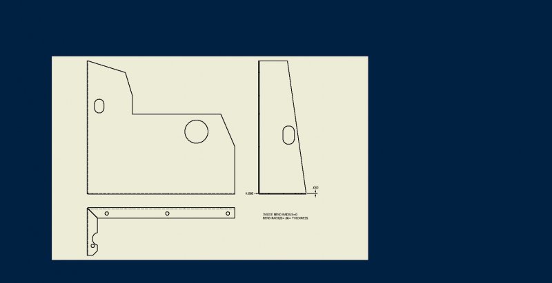

I converted step file in ipt , but I can't convert the ipt model in sheet metal. I followed the procedure about set the thickness, but Inventor don't do it, Inventor cant convert to flat pattern...I don't know what is the problem....Somebody can help me , please?.... I Got this step file from a customer... it seem that he set the inside bend radius =0, and bend radius outside was set equal to thickness, I don't know if the problem is because of this....

Welcome to the forum, It will only work if the if the thickness this consistent, Inventor 2016 introduced bend radius 0 for the first time but don't let that fool you, you can still unfold a step file model with a 0 internal radius in 2011 post the file and I will have a look.
