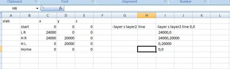

I found another post of yours which I found very helpful using Concatenate, my spreadsheet now looks like this:
Slab		           x	        y	          z
Start	           0	           0	        0		line		        line 0,0
Low Right	24000	   0	        0		line		        line 24000,0
High Right	24000      20000	        0		line		        line 24000,20000
High Left	   0	       20000	        0		line		        line 0,20000
Home	   0	           0	        0		line		        line 0,0

A couple of ways this is the simplest if by layer and layer exists, I suggest add all your layers at start. Also not sure of above but you do not repeat the LINE each row, only need co-ords.
this saves an extra line which may stuff up your excel rowscolumns
-layer s "layer2" line 0,0
24000,2000
0,2000
-layer s "layer3" line 304.9,-1000
600,-1000
etc

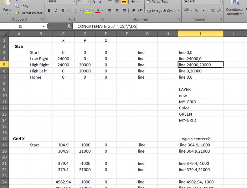

I have so far managed to draw the floor slab and grid - grid drawn in centerx2 - from the advice you have both provided.
The following screenshot might help explain why I have line in every row - I found a post by BIGAL that showed how to concatenate points albeit I used it for lines.
From the screenshot you will note i opted for Steven-G's option as creating a new linetype suits what I am trying to do.
Rows 9 - 14 are my attempt at adding a new layer, giving it a name and giving it a colour however, this is not working how I would like it - the best I can get it to do is open the layer applet and the colour applet, where I have to manually select a colour three times and manually create a new layer.
Is it possible to automate a new layer giving colour and a name?
As I am only just starting out with this spreadsheet, having to add in additional rows is not currently a problem, my spreadsheet contains only 56 rows including spaces. I am really happy at having the grid drawn, just looking to learn how to format it automatically.
Just blank out the "Line" to only as required the concatenate will still work
Column F only 1st line -layer layer2 so now becomes

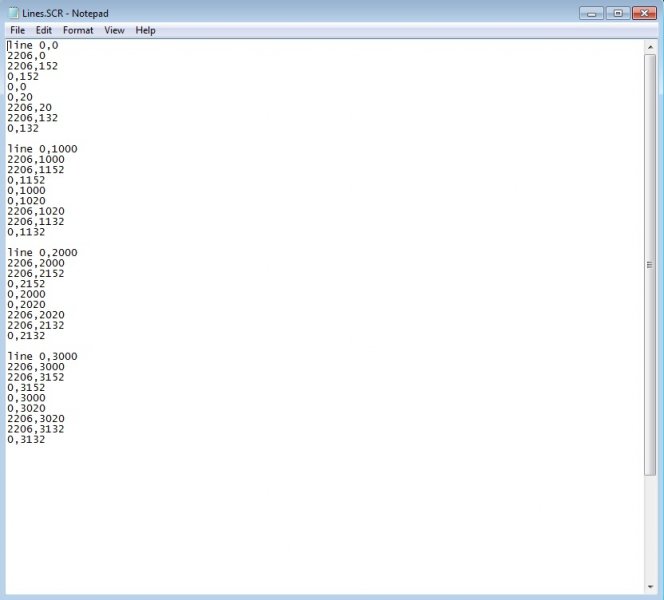

Hi, still trying to refine this further though, I have made some changes but still not understanding why it is not doing what I want it to do, perhaps someone could hopefully help me out?
Okay

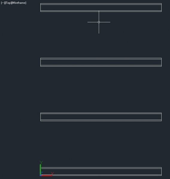

Screenshot 1 shows my script for drawing lines
This gives me the result I am looking for as in the next screenshot

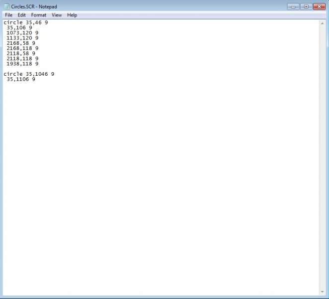

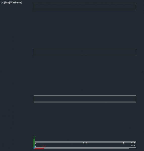

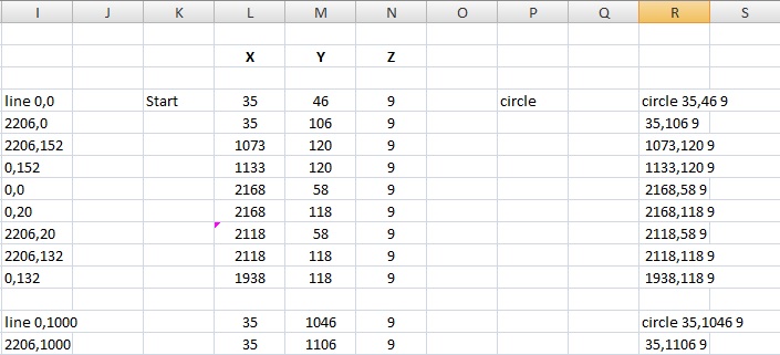

Now I have found that to add circles, I have to have a second script file - having a second script was the only way to be able to get the circles to show up this is shown in the next screenshot
The first 9 lines of this script places circles on the lowest part of the second screenshot as per the next screenshot
The remaining two lines should place circles on the next item up on the above screenshot, however, it does not.
Appreciate if someone could explain what I need to do to get this to work please?
The script files are copied from excel cells and pasted into Notepad.

What do you see on the command line ?
My first thought would be that the blank line after the first set of circles actually causes Autocad to start the circle command again, and it expects the coordinates but the following line starts with the word circle, causing an error.

I have changed the formula in excel to not reference the word circle where you point out and this works to a fashion in that it only shows 1 circle.
Thanks Steven, with your advice I have figured it out, the second circle is now showing using the following
See your other post, re layers type -layer and look at the prompts -layer n abcde c 1 abcde lt center2 abcde you have to imply which layer is using what.
