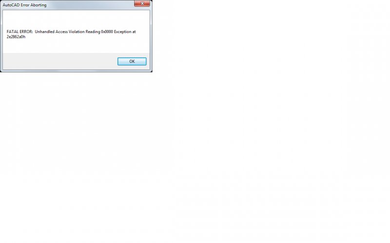

I'm using Autocad 2013 and when I try to e-transmit i get this error. Can anyone help me with this?
Does this happen every time? Or was it a one time issue?
You can always try -PURGE and then -AUDIT
Try recovering the file that is giving you the error.
Where did this file come from?
Is it possible that the file has objects from a newer version of AutoCAD or a vertical product? Meaning that it might have been "saved as" instead of "exported".
It could of been "saved as" with a newer version, can i change that?
You might be able to with Drawing TrueView available free from AutoDesk.
