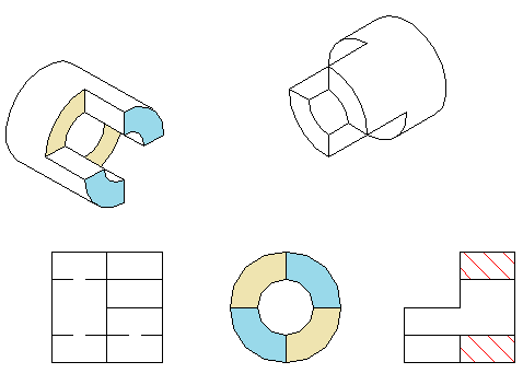

Showing different heights or elevations in Plan View
Is there a common practice to show different levels of a part when looking straight down on it?
Hatching doesn't seem right.
Are you thinking an edge that is higher than another should be shown using thicker lines? Isn't hatching usually reserved for sections?

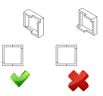

I was wondering if there is a standard way to show that one part of an object is raised above another part in a 2D representation.
IMHO, it's unnecessary. You could use spot elevations (annotation). Mark the top or bottom as "0" and then do relative elevations, but why?

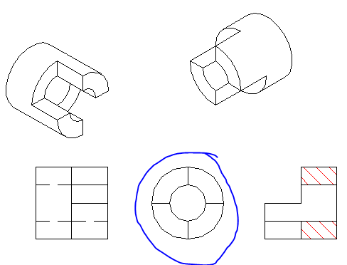

I want to make sure that they make the part on the left, not the part on the right.
It's a much better idea to have different views than to try and squeeze that information into a plan view. A 3D/isometric view accompanied by a couple of sections with that plan view should get you an accurate part.
Three view drawing. Top View. Front View. Side View. Then, if there are still details unseen, another Side View, and even maybe a Section View. It's been the accepted standard since the pyramids were designed.
