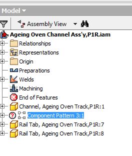

I re-saved an assembly under a new file name and deleted some parts to create a sub-assembly. I was presented with a red question mark in a black circle in the browser. What is the significance of this and what do I need to do to repair the drawing which is currently having difficulty saving ?
Never mind. The component pattern was defective because I used a feature on the deleted part to establish the direction of the pattern progression. As soon as I edited the pattern everything was o.k.
