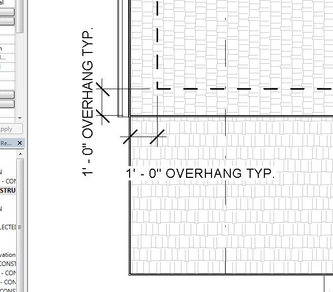

I have attached a screenshot of my issue, which is that I cannot get my tag to work correctly. In the past, I have been able to drag the text on my dimension tag and a small, curved line will connect it to the dimension it represents. Now, (on a new computer), when I drag the text, no line appears. What setting do I need to change?
Select dimension and in properties check 'Leader'.
