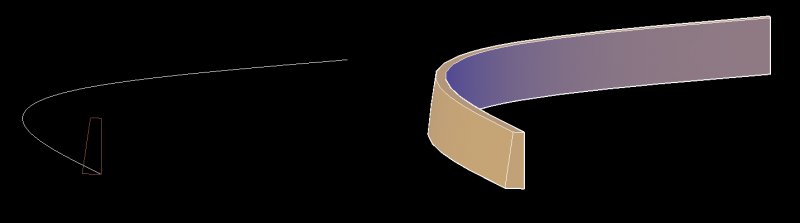

SSArchi Posted October 10, 2015 Posted October 10, 2015 Hey all, I haven't used CAD in a while and am using CAD 3D for the first time. I have an elevation and a plan and I am trying to curve the elevation wall along a curve on the plan. How can I make it bend/curve along that specific curvature? The elevation is of course straight but i need it to be curved. I'm not even sure if that's possible but Thanks in advance for your help Quote
ReMark Posted October 10, 2015 Posted October 10, 2015 (edited) Take a profile of your wall and either sweep it or extrude it along the path of your curve. A fairly straight-forward and easy thing to do. For example: Edited October 10, 2015 by ReMark Quote

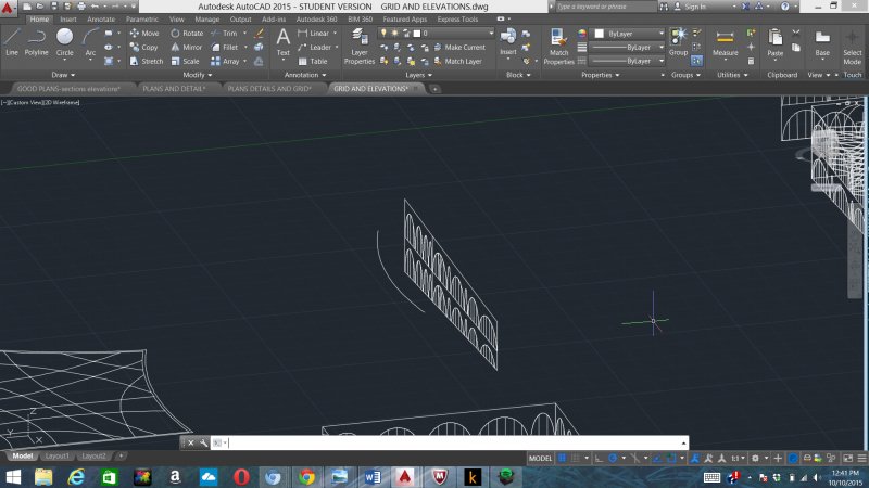

SSArchi Posted October 10, 2015 Author Posted October 10, 2015 This is what I'm working with. I want that elevation to bend along that curve next to it. Would you suggest i try the same thing you just described? Quote
steven-g Posted October 10, 2015 Posted October 10, 2015 Definately not. This technique can not curve a vertical arc onto a curved surface, this is an old thread but shows one possibility http://www.cadtutor.net/forum/showthread.php?64610-mapping-a-2D-drawing-onto-a-3D-curved-surface And I believe that SEANT also has a more recent method. But now that we can see what you are after hopefully someone will step in with a workable technique Quote
BIGAL Posted October 10, 2015 Posted October 10, 2015 My $0.05 I am not an expert in 3d but this is my go at your problem. As full 3d. The arch cutouts should be located true tangent to the curved wall. If you want a 2d+ drawing then its possible to think about old fashioned flat plate unfolding eg funnel, by using arc lengths and lines vertically then a parabola joining the lines. yes a lisp would do that. Quote
steven-g Posted October 12, 2015 Posted October 12, 2015 Searching around, this type of question appears quite often but all I have found are references to Inventor and sheet metalwork. As BIGAL says in Autocad the only way I can see it being done is using mathematics (arc length, using center,start,length and then from there add in a height) but that only gives a series of points that you would need to join up, and you would need to decide what accuracy you need for that. And that only gives you a line drawing or points for a spline which is fine for a visual representation, but I don't know how you could then convert that to a true 3D model, such as a mesh or solid. Quote
