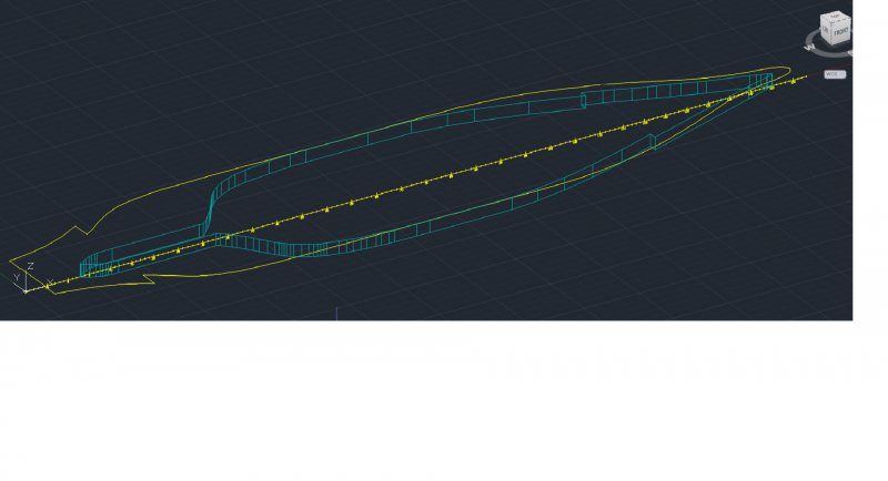

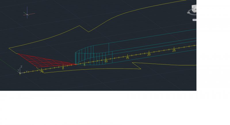

liquid-blue22 Posted October 14, 2015 Posted October 14, 2015 Hi Guys, I am new to the forum but have been using the tutorials on and off for the last few months, they have been great and to be honest have covered everything I needed....until now My problem (and I am really hoping someone can help me) is that I am trying to create a vessel hull, the end use software requires the hull be a solid not just a surface. I have several to spec GA drawings for the vessel and what I have done is put them into CAD and have layered the plan views at the correct heights, see below... I have extruded the lower level (blue) from the 0 point Z axis up to the yellow level (ballast level) and hidden the levels above the yellow layer just to make it a little clearer, basically I want to create a hull like shape between the yellow outline and the blue in solid form, but am drawing a complete blank on how to do it... Below should be an image of the hull with one surface created to show the angle (all the way around) i am trying to achieve with a solid.... I need to do it all the way around the yellow layer to join to the blue layer in solid form, I am not worried by having the hull arched (although it would be nice) I just hope there is a way of doing it as the only way I can think of is to keep making and extruding surface for each small part of the hull, this would take months of me fiddling with the ucs to create individual surface layers Any help on this would be great Sam Quote
ReMark Posted October 14, 2015 Posted October 14, 2015 Have you tried lofting a series of profiles? There are CAD programs specifically designed for this type of work. Why aren't you using one of them? Quote
liquid-blue22 Posted October 14, 2015 Author Posted October 14, 2015 Why aren't you using one of them? Lack of knowledge Quote
ReMark Posted October 14, 2015 Posted October 14, 2015 Well try the lofted profiles idea and see what results you get. Quote

liquid-blue22 Posted October 15, 2015 Author Posted October 15, 2015 thats okay given the way its going it may end up looking more like a piece of pottery ;-) The loft function is great, i have been having some fun playing around with it, but I am having a problem making it to a solid, I will carry on playing with it before I ask any questions, as its probably just me doing something stupid Quote
ReMark Posted October 15, 2015 Posted October 15, 2015 You may have to resort to using the THICKEN command. Quote
liquid-blue22 Posted October 15, 2015 Author Posted October 15, 2015 You may have to resort to using the THICKEN command. That's brilliant and worked really well for the base, unfortuantly the sides of the hull yielded this; "surfaces cannot be thickened with specified value. Object intersects itself." Is there anyway around that? Quote

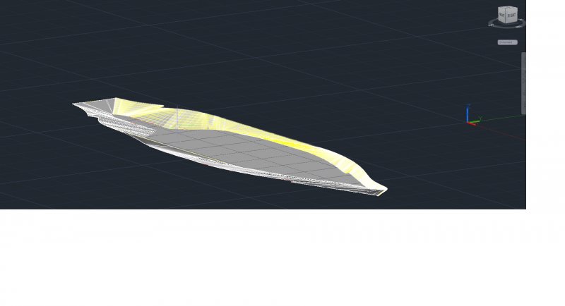

liquid-blue22 Posted October 15, 2015 Author Posted October 15, 2015 Ah, why do I have a feeling that is the same as going right back to the beginning. The hull geometry is both concave and convex and unless I work outside the GA drawings I can't see any way I could clean the geometry up. This is what I have now the loft command is run but it has only created a surface and I really need a solid: Quote
ReMark Posted October 15, 2015 Posted October 15, 2015 When you attempted to use the thicken command what thickness did you specify? Quote
liquid-blue22 Posted October 16, 2015 Author Posted October 16, 2015 I started quite large without meaning too, I started with about +1.0m, after realising my mistake I then tried +0.1, then +0.0001. All resulted in the same. Quote
ReMark Posted October 16, 2015 Posted October 16, 2015 Without an actual copy of the drawing to experiment with I can't give you a definitive answer one way or the other. I think you should find a more suitable program for doing hull design other than AutoCAD. Quote
liquid-blue22 Posted October 16, 2015 Author Posted October 16, 2015 I will carry on playing with it, hopefully its just me not explaining things very well :-) File attached for anyone interested AHV.dwg Quote
liquid-blue22 Posted October 16, 2015 Author Posted October 16, 2015 I have done it :-) So in the end I basically created a Keel level planar surface which I then extruded into a solid to the height of the next deck, I then used the "lofted" surface to slice the shape I needed Thanks again for all of your help with this Quote
