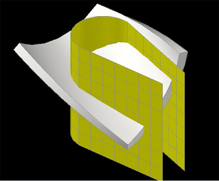

Well u can use the extrude command. But if you wanna make it more realistic, like the blades having the twist effect, u need to play with the sweep and slice with surfaces.
whoo that's crazy. but when i try to extrude i get this massage "Cannot sweep or extrude an object of this type." here it is ( i put on title), l i just want to mak the blade thicker, and look like a solid, that is all.
Well, you can't actually extrude the block, but if all you want is a bit of depth, not worrying about blade pitch, etc..., you can explode it and convert one of the blades to a closed polyline and extrude that. You can convert the blade to a polyline either with PEDIT (polyline edit) to join the lines, or you can use the BOUNDARY command.To create a boundary, start the command and bring up the dialog box, where you can choose to create a polyline or a region, either will work in this instance. Next click on the select points button and pick the area inside one of the blades of the fan (or all the blades, your choice). Once you're finished selecting you can right click or hit enter to create the polylines. Then go ahead and EXTRUDE the blade(s) to your desired thickness. If you only did one, select it and ARRAY (polar array) it around the center section to create the rest.

AWESOME IT WORKED!!!! I just typed BOUNDARY, like you said and it coveted it to poly lines(super helpful) THANK YOU ALL FOR REPLYING!! If i could i would shake your hand or something extreme like that,lol.:) thanks again.
