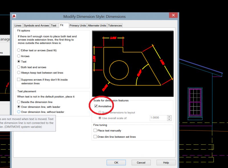

Dana W Posted October 14, 2015 Posted October 14, 2015 Dim style set in what way? Maybe somehow the dim style became annotative and is changing with the annotation scale of the current view. Quote
Tripp Posted October 14, 2015 Author Posted October 14, 2015 My firm has preset dimension styles for our most frequently used output scales. I used the one that corresponds to my intended scale 1/2"=1'-0". The dimstyle did not change. I think there is something going on with the base file. I am not having the same issue with any other files. Perhaps the file creator included some setting that i don't know of? Quote
Dana W Posted October 15, 2015 Posted October 15, 2015 The only setting that could possibly change the font size of a dimension is the Annotative setting in the dimension style editor, as I mentioned before. Did you take a look there to see if the style has been made annotative? You failed to mention the item at all. See the image below. An annotative dimension will show in ALL scale sizes assigned to it when it is selected whether selected alone or in a bunch of objects. Can you possibly post the drawing here, so someone can look at it? Quote
ReMark Posted October 15, 2015 Posted October 15, 2015 Attach a copy of the drawing file (a .dwg not an image file) to your next post so we can have a look for ourselves. It will save us all a lot of time and trouble. Thank you. Quote
Tripp Posted October 15, 2015 Author Posted October 15, 2015 Thanks for your help. I asked a colleague before I joined this site and he steered me in the wrong direction. When I set my dim style I just enter the text height I want. He set the overall scale to 4.5 because he uses 1" text height and scales it up. Quote
