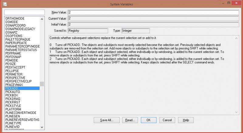

I know you said you understand the PICKADD settings, but in case someone else might not, I have attached a screenshot from the SYSVDLG box.
Wherein, I might add, one can use the SAVE ALL option to create an .svf (system variable file), which is always a good thing to have, and will one day come in very handy, unless of course you have never created one, at which time you will wish that you had.
