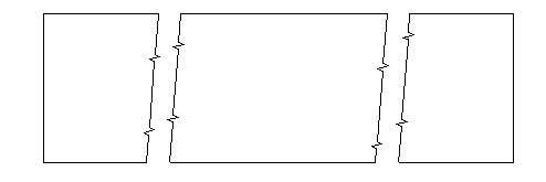

I would like to know, how can i made the interrupt line.
In line properties, on load button, don't have any type of this line. The line that i'm talking about is attached.
Could you help me?
Thanks
Look under Express Tools > Draw > Break-line Symbol.
Or....create a custom linetype of your own design using the MKLTYPE command also found under Express Tools > Tools.
Thanks. Its correct... Explain also, how can i do this symbol bigger, and im mid of the line. The scale, is not the best way (I think...)~
Best regards
That's covered here....http://knowledge.autodesk.com/support/autocad-civil-3d/getting-started/caas/CloudHelp/cloudhelp/2016/ENU/AutoCAD-Core/files/GUID-88667D3B-C98B-4C02-85F4-232DD4950841-htm.html
I don't use the symbol much but as I have just tested it the command is so simple you should be able to do what you want just by looking at the command line options. Note that there is one for Size and that Midpoint is the default location for the symbol. It does not get any easier.
Very easy. Thanks for all. Best regards
