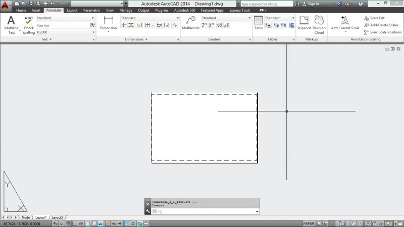

Mt laptop at home is setup perfectly. At work, I still have to tweek stuff around. Most is all good except one little quirk. I choose to use 2014 while there because my pc is having issues with the latter. My only real profile issue at this point is that I cant figure out how to set the background outside the paper space. What I mean is, outside the box where you work there is a background that does not move. My laptop, the ps box is set to white for preference and the outer is set to like a grey shade or so. At work both the box and outer background are both white. You would probably say change paper space box to black. That is not what I want to do. I like MS black and PS white. I just need background outside ps box a darker color. Reason, if I move my mouse outside the ps box (white) to the background area (white) my mouse dissapears. This is annoying. I lose it sometimes. I want it liek the attached image. At work that entire screen is white.

the 2014 version at work has background white. i do not understand. mine at home is grey.

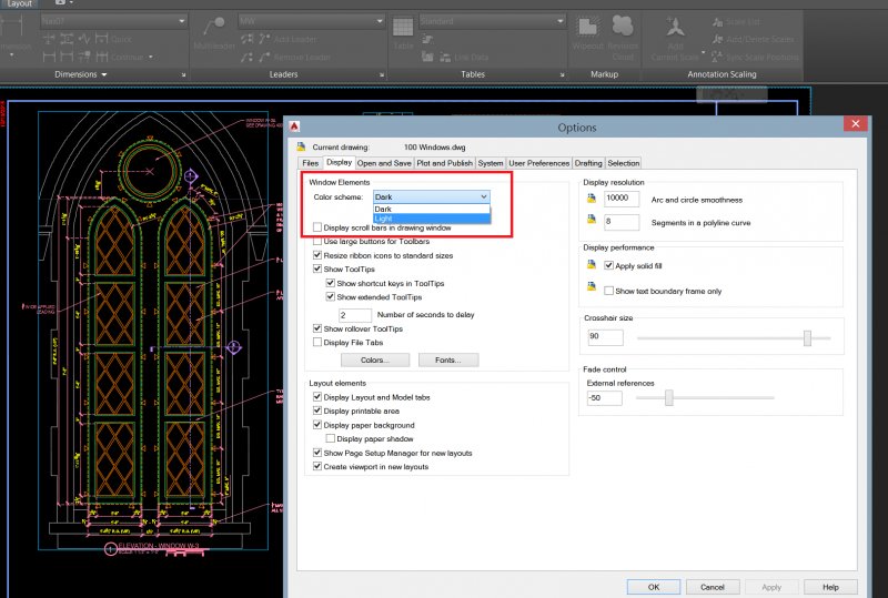

If this is set to Light, then switch it to Dark.
