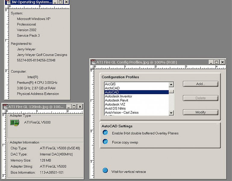

JWeyer Posted January 14, 2009 Author Posted January 14, 2009 Thanks again for all the hard work and interest... I just tried "Golf CL 07.lsp" with osnap "off" and it works as expected. Turn osnap "on", move cursor around the screen and no problem, move cursor closer to expected tee location and bingo! Same error msg again in the same drawing... In case your are wondering about my operating system, I've attached screen shots just for info... Intel D915GEV mother board, 3.00 GHz, 2.87 MB RAM on XP (4.0 GB on VISTA), ATI FireGL V5000 GCard. I just tried to some tweaking on the video card but still experienced the same problem upon retesting. I really think that we are dealing with a problem within autocad, windows or my computer. I'm going to test this on my laptop and see what the results will be. I have a feeling that it will work on my laptop as expected. I suggest that you not waste any more effort on this elusive problem. Let's just turn "off" the osnap at the beginning and turn on at the end, if was on at the beginning, and move on... Thanks again, Jer Quote

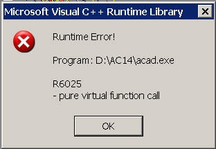

JWeyer Posted January 14, 2009 Author Posted January 14, 2009 I believe that I've finally identified the root cause of the error problem. It's a "-pure virtual function call" from AutoCAD to the "Microsoft Visual C++ Runtime Library". (See Attached Image) The "Unhandled Exception Violation" will ALWAYS occur when the Osnap Setting "Nearest" is selected. Also, the "Unhandled Exception Violation" will SOMETIMES occur when the Osnap Setting "Apparent Int" is selected, depending on when you turn it "On" when drawing subsequent pline(s). I tested this while using just the pline command and the attached DWG file (Set your "Background" color to "DK Gray" for viewing my color settings) over, and over while using different Osnap setting. I found that AutoCAD would sometimes seem to "add" the "Nearest" setting. I don't know what version of MS C++ was used for R14, nor if, or when this problem was ever corrected. Later versions of AutoCAD may or may not have this same problem... I hope that this will help others that have had similar problems with Unhandled Exception errors... Have a great day! Jer TopoEndPts1.dwg Quote
Lee Mac Posted January 14, 2009 Posted January 14, 2009 Blimey JWeyer, never heard of that error before - although you don't really know how many changes have occurred to C++ since R14 of ACAD, so there may well be some compatibility issues. Quote
