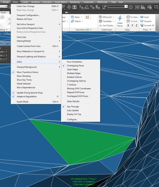

Cad64 Posted October 28, 2015 Posted October 28, 2015 I imported your dxf file into Studio Max and ran some tests on the mesh. If you go to the "Views" menu "xView" you can check for things like open edges, overlapping vertices, etc. I didn't find any trouble with those, but I did find that you have 7 overlapping faces which are shown as green in the screenshot below. You will need to fix those and then you should be able to export to IGS. Also, when I imported the dxf, in the Import Options, I chose to "Weld Nearby Vertices" with a Weld Threshold of 0.03". After the object imported, it was completely black which means the polygons are inverted. So I selected the object and converted it to Editable Poly. Then I switched to Polygon selection mode, window selected the entire object and clicked the "Flip" button. Once all that was done, then I ran the xView tests I mentioned previously. Hope that helps. Quote
