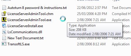

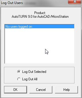

The correct way you can via the license manager see who is actually using Autoturn this is ran from Outside Autocad as its part of the network license manager I know this because I manage it. A word of caution if you give everybody access to the management 1 they can kill anyone, 2 they can totally stuff up the network license. We use the same a Autoturn emailgroup if I get a message I normally check as a rule who is using, we have a pretty good response to the request for a user to release the software, they reply to group. You can unload the arx also to release and not close your Autocad. Appload, Loaded applications, at2013x64.arx

And thanks to the other peeps. I now atleast made a command that unloads the ARX.
However i am not able to check the license myself unless there should be a webbased interface. We have no control over the license server machine.

Management of a server is not just a global access you have immense control of who can do what, you could be given permission to use only that program to check who is using. You can hide, view, run, read, write all sorts of combos. Contact your IT admin.
