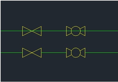

narendra Posted November 14, 2015 Posted November 14, 2015 Hi Every one I have to place no. of valves (blocks) on lines every time I am trimming lines behind the blocks it is taking more time is there any way to auto trim lines behind block while placed on lines. Look at attached jpeg. Quote
ReMark Posted November 14, 2015 Posted November 14, 2015 Forum member and lisp guru Lee Mac has created a lisp routine that might be of interest to you. It's called Automatic Block Break and it can be found here... http://lee-mac.com/autoblockbreak.html Another way to handle the problem is to use the Snap and Grid options but this would mean the width of all of your blocks would have to be the same. Quote
narendra Posted November 14, 2015 Author Posted November 14, 2015 thank you remark, my all blocks are same in width could you tell me what is the another way Quote
RobDraw Posted November 14, 2015 Posted November 14, 2015 Put a wipeout in the blocks. The line won't get trimmed which will allow you to move the valves without reworking the line. Quote
narendra Posted November 14, 2015 Author Posted November 14, 2015 rob, I have already made wipeout but while copying blocks to other drawings wipeouts are not showing in other drawings and while panning lines visible under blocks, I want to trim permanently lines under blocks Quote

RobDraw Posted November 14, 2015 Posted November 14, 2015 while panning lines visible under blocks, I want to trim permanently lines under blocks Unless you print while you are panning, lines showing up while doing this is a none issue. So, you came across a stumbling block. Instead of making a more intelligent solution work, you give up and want to opt for something that actually requires more work. That's your choice. I've done plenty of one-line drawings over the years and much prefer blocks with wipeouts over trimming. Quote

Dana W Posted November 14, 2015 Posted November 14, 2015 rob,I have already made wipeout but while copying blocks to other drawings wipeouts are not showing in other drawings and while panning lines visible under blocks, I want to trim permanently lines under blocks The lines under wipeouts will ALWAYS be visible when panning or manipulating a wipeout in any way. Wipeouts are a very large load for your video processor, so they are put to sleep, so to speak, while they are moving across the screen. Quote
narendra Posted November 15, 2015 Author Posted November 15, 2015 Forum member and lisp guru Lee Mac has created a lisp routine that might be of interest to you. It's called Automatic Block Break and it can be found here... http://lee-mac.com/autoblockbreak.html Another way to handle the problem is to use the Snap and Grid options but this would mean the width of all of your blocks would have to be the same. thanks remark, guru Lee Mac lisp routine is working nice......But as he is mentioned in the link regarding custom program I am not aware of lisp, routine is suitable for my need but I am placing blocks pickimg from tool pallete in that case this routine is not supporting (ABB lisp routine), could you please help me to modify lisp routine to support picking blocks from tool pallete. naren Quote
