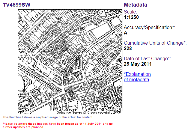

Tried it with these co-ordinates 548237,099194, this is a location down south near the coast in Seaford. It put up on screen co-ordinates give TQ4891NW, whereas using the UK grid finder it gives "TV 48237 99194" so the TQ change in value to TV. Therefore this lisp while it ok for say the London area it doesn't cover the whole of the UK. I will try and get hold of the corner co-ordinates for each of the TQ or TV or T? tiles and take it from there.
Thanks for your assist.
You are using the lisp programme outside its quoted parameters. It is titled for TQ tiles only, so you should not expect it to give you a TV tile :cry:
If you look into the workings, it expects a Northing of six significant figures, and your example only had five significant figures (the leading zero is not a significant figure), so no wonder it is giving unexpected results.
The OS has quite a good tile finder on line
