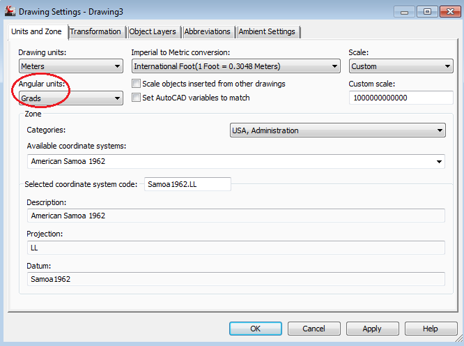

Two simple problems - which hopefully have two simple answers:
I am writing a script to change the ambient drawing settings (see screenshot).
Everything works except I can't close the text window after running the units command, and the ambient angular units don't get set (highlighted red in the screenshot). Is there an ade command that'll do this?
cheers,

   (command "-aecdwgunits" 6 2 3 "No" "No");works
   (command)
   (command "-units" 2 3 2 8 270 "Y");works - but doesn't set ambient angular units
   (command)
   ;Shut off text window
   (command "graphscr"); doesn't work
   (command)

Behind say Units is a series of variables as an example below there should be the same for aecdwgsetup just need to find, 2 ways use express, tools, System variable editor.
Or do setvar ? * change 1 at a time.

You need to get the Ambient Settings Object through the Civil Application Interface. This may get you going.

(setq aeccApp (vlax-invoke-method (vlax-get-acad-object) 'GetInterfaceobject prodstr));Get the Civil Application
(setq aeccDoc (vlax-get-property aeccApp 'ActiveDocument)) ;Get the Active Civil Document from the Civil Application
(setq sets (vlax-get-property aeccDoc 'Settings)) ;Get the Root Settings from the Document
(setq dwgset (vlax-get-property sets 'DrawingSettings)) ;Get the Drawing Settings from the Root Settings
(setq ambset (vlax-get-property dwgset 'AmbientSettings)) ;Get the Ambient Settings from the dwg settings

Ok so the script is working now and does what I want it to do...except the text window will not close. (graphscr) returns nil as expected - so I have:
(graphscr)
And I've tried various iterations:
or
(command "_.graphscr")
And they all return nil so I know its running the command...yet the text window just will not close....
If I run any of those after the lisp has completed it close the window as expected. Or if I hit F2 it closes - just not from the lisp....grrr....
Any thoughts?
