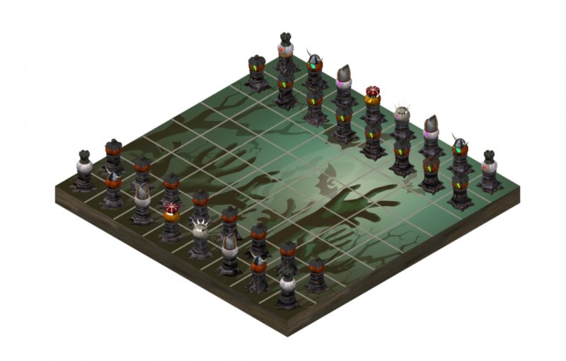

CadManDoo Posted November 29, 2015 Posted November 29, 2015 This is Driving me nuts! Has anyone ever had a problem with Surface material mapping Loosing its mapping when you move, scale, copy, the object or simply close and restart the drawing? I've finally got my Final Project Modeled and now all I have to do is render it but it keeps crashing and then I have to reset all the surface material mapping on the objects I copied. I working on a Macabre Chess Set If you look at my rendering you'll see what I mean. The Tree Stumps and the Pawn Hillbilly hats. Quote

CadManDoo Posted November 29, 2015 Author Posted November 29, 2015 Now it's doing this thing where I zoom in and the material disappears and then reappears when I zoom back out. Only happening to the Tree stumps though. It's only happening to Custom image Materials applied to surfaces of copied objects the original object always seems to keep it's mapping. I've got a lot of High Definition Custom image materials in my drawing, Is this maybe why I'm having problems? Quote

CadManDoo Posted November 29, 2015 Author Posted November 29, 2015 I realized when I copy an object with surface material mapping applied it stretches the image way out as if I had selected all surfaces of each copy and the applied mapping all at once. I thought I had found a solution by duplicating the material 31 times (yes I said 31) for each piece and then applying it all separately but now it's doing this thing where some of the objects materials appear to be there only when it fells like it. Quote
