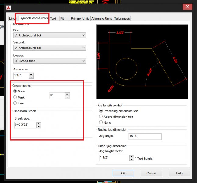

Back to my review question: The style manager tab where center mark style is defined. Guess what the correct answer is: "Lines."
I don't get it. Right there on the Symbols and Arrows tab is a box for defining center marks.

Send her another email and include this picture. The test is completely wrong.
