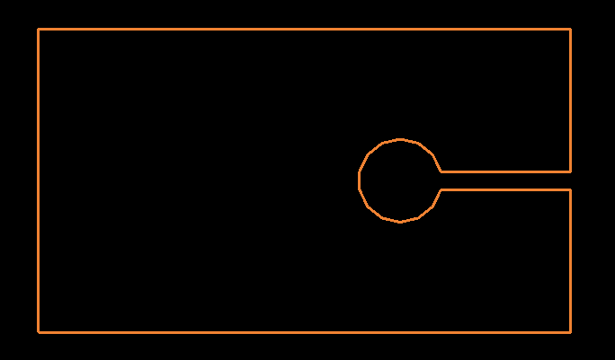

SAFeSTeR Posted December 7, 2015 Posted December 7, 2015 Hi, Just wondered if it's possible to create a viewport with a 'hole' in it like in the image? The most difficult thing I've done with viewports is to create a polygonal one (that's a bit of a lie, but you get the idea). I've tried experimenting with the object / clipped options but have achieved nothing but failures. My reason behind this is that I want to place a table in the drawing (self made, not an AutoCAD table, which I can't get on with) but I want a clear background. I know I can use a hatching behind the table but thought there must be a better way. Quote
RobDraw Posted December 7, 2015 Posted December 7, 2015 This is how I used to do it. There may be better a way. I've exaggerted the spacing of the lines to the right of the circle to show intent. Clip the viewport to a polyline similar to this. HTH. Quote

RobDraw Posted December 8, 2015 Posted December 8, 2015 What do you mean by clipping to a polyline and HTH though? I use vport clip to make the viewport the shape of the polyline. HTH = hope that helps Quote
SAFeSTeR Posted December 8, 2015 Author Posted December 8, 2015 I have tried dtkell's 'region' method and it works well, however, experimenting threw up another question: What, if any, are the main differences between the commands -VPORTS and MVIEW? I couldn't seem to find any I use vport clip to make the viewport the shape of the polyline. HTH = hope that helps OK, thanks. Sounds similar to the 'object' way but I guess you can edit an existing viewport to take on the shape of an object? Quote
