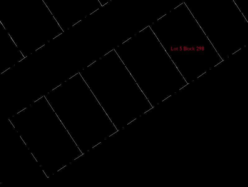

Thank you Tharwat,
The ultimate format that I would like to achieve using the same example is: Lot 10 Block 298 on two lines.
I'm also really struggling on how to get the user to pick the label location.
Let's get this straight before giving any solution . okay?
Do all the layer names have the same format or length of chars ? I mean , four numbers = year , three numbers = Block , two numbers = Lot ?
You are talking about one layer , or all the other layers have the same LENGTH of chars?
They do vary slightly. It will always be four numbers = year , three numbers = Block , varies = Lot, but lot could be everything after the "-".

Okay , replace this:
(setq tObj (mk_txt
                (setq p (polar iPt (+ lAng (/ pi 2.)) (* oFac tSze)))
                (vla-get-Layer (vlax-ename->vla-object ent))
with this:
(setq lay (vla-get-Layer (vlax-ename->vla-object ent))
             tObj (mk_txt
                (strcat "Lot " (substr lay 9) " Block " (substr lay 5 3))
And finally , add the variable to be localized like this:
(defun c:LBLL (/ *error* mk_txt DOC ENT I IPT LANG OFAC P SPC SS TOBJ TSZE UFLAG [color=red][b]lay[/b][/color])
Works like a dream!! Thank you so much! Not to push my luck here but... :)

           lay (vla-get-layer (vlax-ename->vla-object ent))
     (if
       (setq
         tobj
          (mk_txt
            (setq p (polar ipt (+ lang (/ pi 2.)) (* ofac *hgt*)))
            (strcat "Lot "
                    (substr lay 9)
                    "\\PBlock "
                    (substr lay 5 3)
          (vla-put-height tobj *hgt*)
          (vla-put-attachmentpoint tobj 5)
          (vla-put-rotation tobj lang)
 (vla-endundomark doc)
