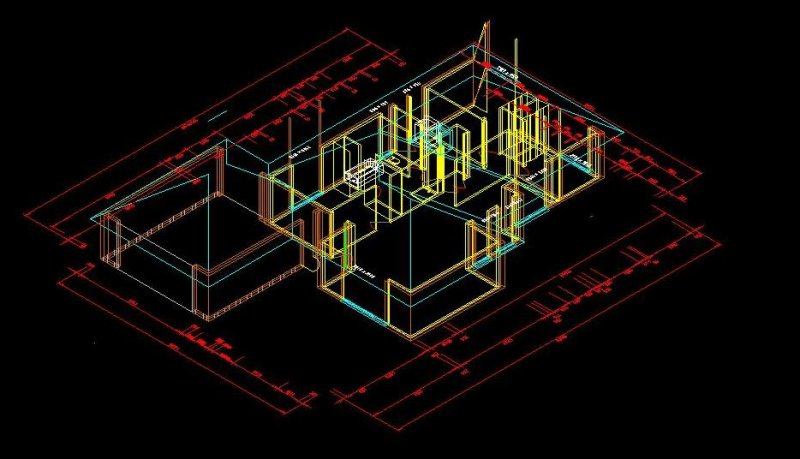

This gives you an idea we could add your trusses to this. Drawn by CAD-ARC
