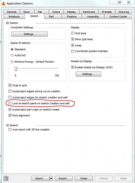

I'm a very beginner to Inventor. When I open a Sketch and try to select a plan it turns to a different position from the one showed in the tutorial, how that happen?

Look at item "Application Options" on "Tools" ribbon (see screen shot below). Is "Look at sketch plane on sketch creation and edit" checked? I'm not sure what is happening from your description but it sounds like this might be checked. When you click on a plane the view rotates around to look at the plane instead of just activating the plane and leaving the view unchanged. If that's not the problem/cause then some more info (or screen shots) would be good.
