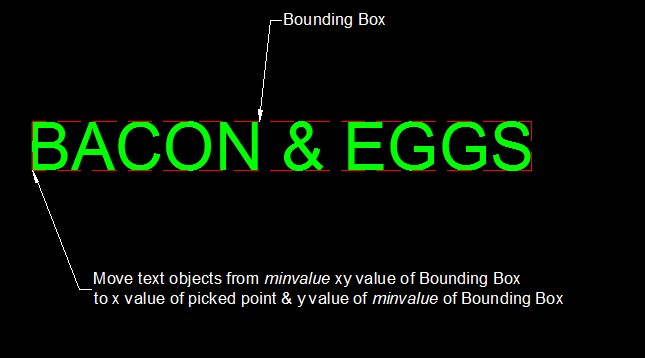

Move text using vla-getboundingbox method (non dynamic)
This has undoubted been done before but I cannot find a simple(?) lisp to move text objects to a picked x or y value (see picture).
There's Lee Macs Dynamic text align but I'd prefer non dynamic.
There's also CAB's alignall, but I've had a few problems with it.
The code I've got is:
(defun c:mtx ( / ap ent obj point1 point2 ss )
 (vl-load-com)
 (setq ap (getpoint "select alignment point"))
 (setq ss (ssget "_:L" '((0 . "TEXT,MTEXT"))))
 (setq ent (ssname ss 0))
 (setq obj (vlax-ename->vla-object ent))
 (if obj
     ;;obj is a vla-object
     ;;point1 is the lower left point of the bounding box around the object
     ;;point2 is the upper right point of the bounding box around the object
     (vla-getboundingbox obj 'point1 'point2)
      ;;point1 and point2 are returned as a safearray and need to be converted to a list
     (setq point1 (vlax-safearray->list point1))
     (setq point2 (vlax-safearray->list point2))
     (command  "_.move" ent "" point1 "_none" (list (car ap) (cadr point1) 0.0))
   );; progn
 );; if
It crashes on the MOVE command
I only added ent because I thought the MOVE command may not work on a vla-object(?)
I don't see anything wrong with your current code, except that it will only operate on the first object in the selection; other than that, it should perform as you have described (at least, for Text/MText at zero rotation and residing in a plane parallel to the WCS plane).
Ignoring UCS & rotation issues, you may find it helpful to restructure the code in the following way, so that the lower-left point may be used as a visual aid when specifying the new position:

Here's why:
(setq bpt (getpoint "\nSpecify alignment point: " llp)) ;; 'llp' is not defined at this point
(setq ent (ssname sel 0)) ;; You are always retrieving the first entity in the set
I would suggest:

That's exactly what I'm after, thanks Lee.
It'll be a doddle to add a align by Y coordinate option as well with that using a initget/cond & the necessary changes to the line:
(command "_.move" ent "" "_non" (list (car (vlax-safearray->list llp)) 0.0) "_non" bpt)

I've just retested it & there's no problem **ODD**
Since I last tried it the PC has been shut down & restarted later, perhaps the code gliched on something changed whilst the code wasn't fully reloaded
I've really no idea, I must have been closer than I thought.
Edited by Happy Hobbit
In case anyone else can use/improve/adapt it to something else, here's the code I finally settled on:
