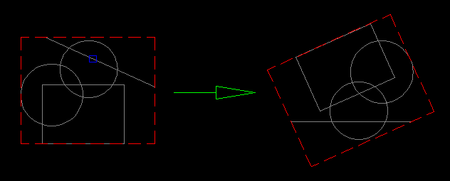

Could you elaborate on what you mean by 'align a selection to the X axis'?
For example, should the selection be rotated about the center of its bounding box such that the point on the selected object is aligned with the x-axis? e.g.:
Lee Mac - thank you!
I have actually thought that part through, but forgot to mention it. Due to my inexperience, I was keeping it simple. I was looking to make the center point of the target line segment to be the center of rotation. The ideal, once I figure out how things work, is to rotate it around the center of mass and then move it to the nearest empty space on the drawing.
Grrr - that's looks like it's close enough to what I want, and will probably contain enough code for my untrained mind to cobble it together with quick mirror to make something.

Here's a very simple (and heavily commented) approach to get you started, compatible for alignment with lines only:
