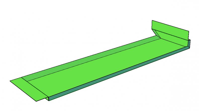

I am intending to model bent plate elements similar to this:
And would like to be able to produce 2D developments from the 3D object.

I don't know about the "best", but Inventor certainly can do this. I believe you must get the Inventor Pro version. Here is an example I found:
I consult with a manufacturing company for the AutoCAD and Revit needs, but they primarily use Inventor and I have seen some amazing things come out of that software. Pretty robust I must say.
