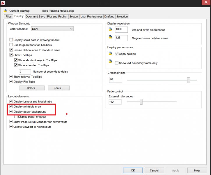

Im trying to create title blocks on 11x17 and 8.5x11 paper sizes while maximizing my printing space. Does any know how far is the offset from the edges of these sheets to the print area? and is there anyway I could see what the offset is for other paper sizes incase I need to make title blocks for other sizes?

Do you have these two elements below checked to display? They are found on the options dialog, Display tab. You can measure the distance yourself with the DIST command(sub command of Measure). It may not be accurate, but it is good within a hundredth or so of a unit. The printable area limit is the dashed line.
