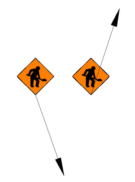

I have created leaders with blocks for our road signage. The leader appears in front of the block though and I am wondering how to send it to back. Can anyone help?
You need to fix it in the block editor using the draw order command, and if that proves to be difficult, I would delete the sign and reinsert it on top of the leader to start with (in the block editor).
