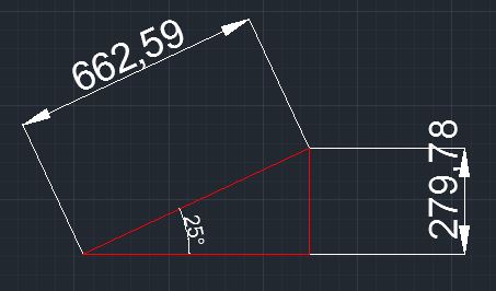

All I want to do is work out the opposite side of a triangle.
I have the adjacent length and the angle but with all these radians and degrees and other crap I just can't get it to work.
When I use a calculator I solve it in a second. But not with AutoLISP.
HDhFEIgsB2Q4sTZABRJ6Sp2OHCCKRhYBsB5YmyAAiT8nTsUMEkchCQLYDSxNkAJGn5OnYIYJIZCEg24GlCTKAyFPydOwQQSSyEJDtwNIEGUDkKXk6doggElkIyHZgaYIMIPK0Iwr+H9qNe7mMkiUQAAAAAElFTkSuQmCCattachment.php?attachmentid=56438&cid=1&stc=1
In the image above, I know the angle 25 degrees and the adjacent which is 600mm (not shown) I need to work out the opposite (shown as 279.78mm)

P.S. if you are using whole angles, the hypotenuse length is 662.03

Ok, I think I have it sorted out. I don't understand why this works exactly or even understand the formula but this is how to work out the opposite side of a right angled triangle when you know the adjacent side and angle
[color=red]([/color][color=royalblue]setq[/color] AngInDegrees[color=seagreen] 25[/color][color=red])[/color][color=gray]; In this example, I set the angle to 25 degrees (not radians)[/color]
[color=red]([/color][color=royalblue]setq[/color] SIDE [color=seagreen]600[/color][color=red])[/color][color=gray]; In this example I set the opposite side to 600mm)[/color]
[color=red]([/color][color=royalblue]setq[/color] AngInDegrees-90 [color=red]([/color][color=royalblue]-[/color] AngInDegrees [color=seagreen]90[/color][color=red]))[/color][color=gray];I then minus 90 from the the 25 [/color]
[color=red]([/color][color=royalblue]setq[/color] c [color=red]([/color][color=royalblue]/[/color] SIDE [color=red]([/color][color=royalblue]sin[/color] [color=red]([/color][color=royalblue]*[/color] AngInDegrees-90 [color=red]([/color][color=royalblue]/ pi [/color][color=seagreen]180[/color][color=red])))))[/color][color=gray];Do some formula[/color]
[color=red]([/color][color=royalblue]setq[/color] b [color=red]([/color][color=royalblue]sqrt [/color][color=red]([/color][color=royalblue]-[/color] [color=red]([/color][color=royalblue]*[/color] c c[color=red])[/color] [color=red]([/color][color=royalblue]*[/color] SIDE SIDE[color=red]))))[/color][color=gray];Do some formula[/color]
What you end up with is a triangle where the opposite side equals 279.78mm. The value of SETQ b = 279.78mm
So it works and if you need to work out this type of triangle this formula will work. Just replace the variable names to suit your own needs.

Your code is essentially calculating the length of the hypotenuse using the known adjacent side & angle, and then using Pythagoras' Theorem to calculate the remaining unknown side length.
You can omit the subtraction of 90 degrees by simply replacing sin with cos.
