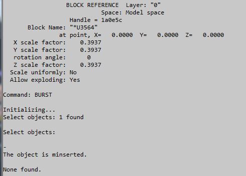

remizana Posted December 25, 2015 Posted December 25, 2015 hi guys, i have a file that has a minsert block in it, i have downloded "explodem.vlx" and put it in support folder of auto cad and then loaded it by "load application", but it seems it is not the right way! any help? Quote
satishrajdev Posted December 26, 2015 Posted December 26, 2015 What error it shows post it here... and what do you mean by minsert block If it's attribute block then try command "Burst". Quote
remizana Posted December 26, 2015 Author Posted December 26, 2015 this is what it says when list it . and I tried the burst command. Quote
rkent Posted December 26, 2015 Posted December 26, 2015 A minsert is made from a block, check to see what blocks are available in the drawing, insert the one used to make the minsert, erase the minsert. Also, look online for XMINSERT.LSP. Quote
remizana Posted December 27, 2015 Author Posted December 27, 2015 hi guys, thanks for the reply I used xminsert.lsp and it did not work Quote
TheCADnoob Posted December 28, 2015 Posted December 28, 2015 hi guys, i have a file that has a minsert block in it, i have downloded "explodem.vlx" and put it in support folder of auto cad and then loaded it by "load application", but it seems it is not the right way!any help? give this a shot https://knowledge.autodesk.com/support/autocad/troubleshooting/caas/sfdcarticles/sfdcarticles/Blocks-inserted-using-MINSERT-cannot-be-exploded.html Quote
Andrew1979 Posted January 1, 2016 Posted January 1, 2016 if this minsert was created with a program called ZW CAD....then I can guarantee whoever did it locked the drawing using ZW CAD. I have found when ZW CAD does its special locking feature on .dwg files, it creates what looks like an minsert but in reality it is something quite different and cannot in any way be exploded. Just a thought in case that is what has happened from wherever the drawing came from Quote
