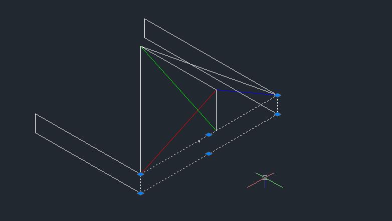

I took a go at two roof pitches having been involved in a architectural addon and its not that hard to do in autocad manually or the smart way via lisp. you take your 3 walls offet them say 450mm fillet them this is eave line. draw a line 30degrees from one of the corners past the mid point draw a line from midpoint past 30 deg line and fillet. Use rotate3d and stand up this gives a ridge line pt for 30 deg do the same for 25deg wall but make line longer rotate3d and you have two crossing 3d lines, using apparent intersection it will allow you pick 3d point. Hopefully the image illustrates the manual method.
Back to lisp (setq 3dintpt (vlax-invoke obj2 'intersectWith obj1 acExtendThisEntity)) the green lines are obj1 and obj2 then use 3dlines pline or pface to make roof.

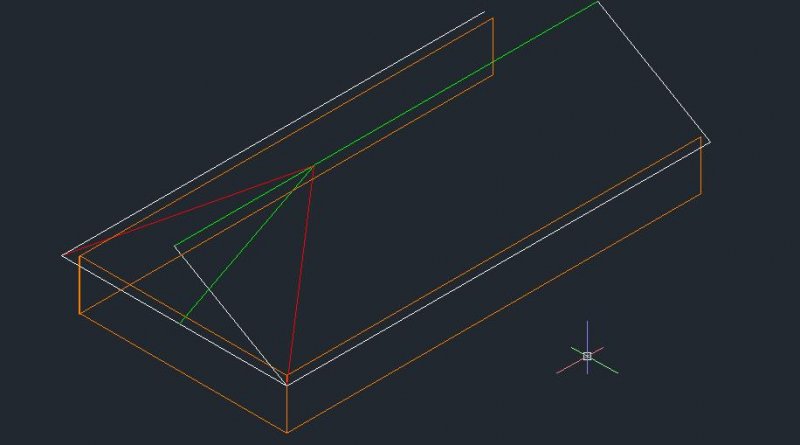

3 different roof pitches using rotate 3d and just fillet the ridge with the end slope line. Note ridge is not centered but pitch angle is based on the correct point from ridge.

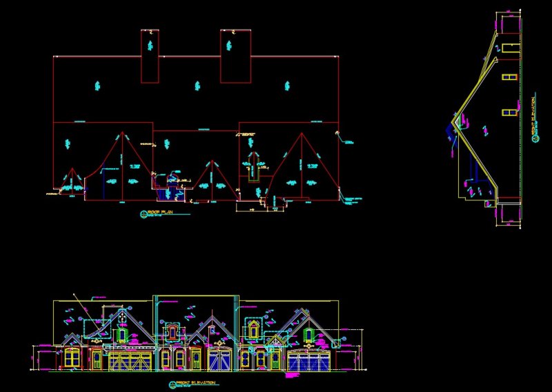

Screenshot_1.jpgWhile a slick little program for sure I learned to build the roof plan from the elevations. Arrange and rotate the elevations around the roof plan and use construction lines to assemble the roof plan.
