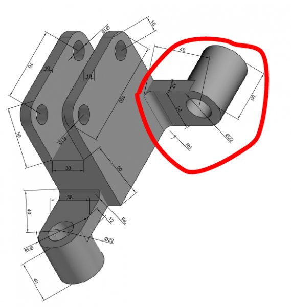

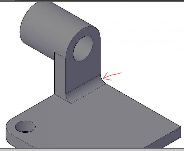

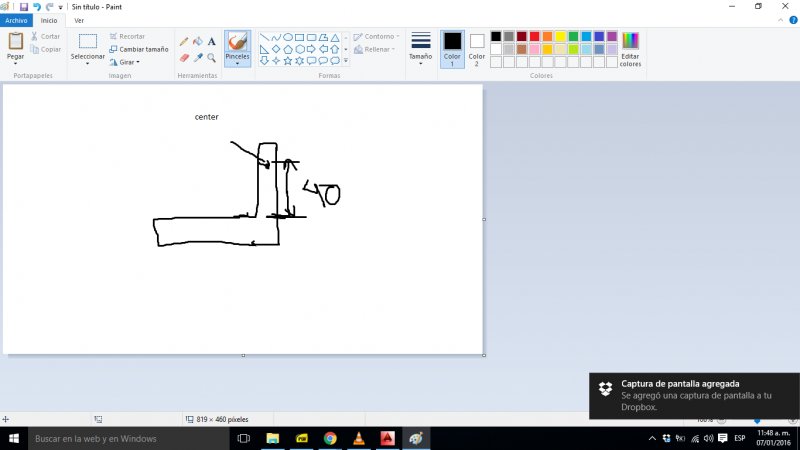

ortizwk Posted January 5, 2016 Share Posted January 5, 2016 Hello I have a question i would like to know how to make a fillet solid, i have a diagram where there is and edge that has a fillet and i can make the fillet in 2d, but i don't know hot to make it like a solid, or how to extrude it in the z direction i'll leave a picture of what i've done and the diagram i want to fill the little hole between the fillet and the round piece. thank you very much for your help. Quote Link to comment Share on other sites More sharing options...

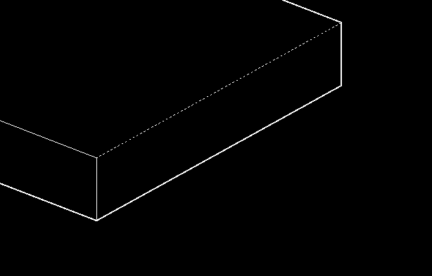

zaphod Posted January 5, 2016 Share Posted January 5, 2016 make the solid longer, then fillet the solid. Quote Link to comment Share on other sites More sharing options...
ortizwk Posted January 5, 2016 Author Share Posted January 5, 2016 what solid the fillet? sorry i don't understand Quote Link to comment Share on other sites More sharing options...
zaphod Posted January 5, 2016 Share Posted January 5, 2016 start the fillet command, select the edge you want to fillet, and the radius, press enter. Quote Link to comment Share on other sites More sharing options...
ortizwk Posted January 5, 2016 Author Share Posted January 5, 2016 maybe i didn't made myself understood, but what i want to do is the piece that is attach to the plate, i will circle it and more importantly the fillet that is form with the piece and the plate. thank you. Quote Link to comment Share on other sites More sharing options...

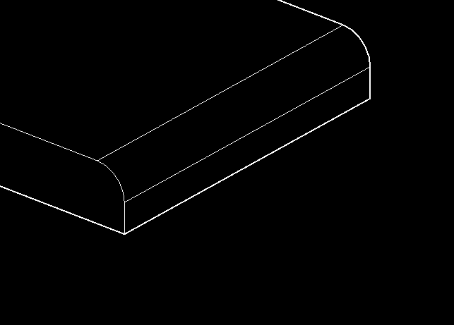

ReMark Posted January 6, 2016 Share Posted January 6, 2016 Use the FILLET command as it will work on 3D solids IF you pay attention to the command line and what AutoCAD is prompting you to do. Quote Link to comment Share on other sites More sharing options...
ReMark Posted January 6, 2016 Share Posted January 6, 2016 Command sequence. Command: FILLET Current settings: Mode = TRIM, Radius = 15.0000 Select first object or [undo/Polyline/Radius/Trim/Multiple]: Enter fillet radius or [Expression] : 6.0 Select an edge or [Chain/Loop/Radius]: select your edge now 1 edge(s) selected for fillet. The result should look like this... Quote Link to comment Share on other sites More sharing options...

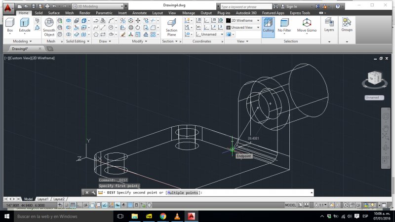

ortizwk Posted January 7, 2016 Author Share Posted January 7, 2016 Hi ReMark thank you very much yes i figure it, but i have another doubt in my diagram from the center of the circle to the corner of the fillet it says it's 40 mm and i don't get that how can i make it 40 mm do you have any idea of how to approach that??? i get that result thanks again Quote Link to comment Share on other sites More sharing options...
ReMark Posted January 7, 2016 Share Posted January 7, 2016 Hi ReMark thank you very much yes i figure it, but i have another doubt in my diagram from the center of the circle to the corner of the fillet it says it's 40 mm and i don't get that how can i make it 40 mm do you have any idea of how to approach that??? i get that result thanks again [ATTACH=CONFIG]56574[/ATTACH] Whoever put dimensions on that diagram did a poor job. The "40 mm" is NOT the dimension from the corner of the fillet to the center of the hole. It represents the distance off the top of the object to the center of the hole. There would be no good reason for it to be anything else. Quote Link to comment Share on other sites More sharing options...
ortizwk Posted January 7, 2016 Author Share Posted January 7, 2016 Are you telling me is this distance? thanks ReMark. Quote Link to comment Share on other sites More sharing options...
ReMark Posted January 7, 2016 Share Posted January 7, 2016 [ATTACH=CONFIG]56575[/ATTACH]Are you telling me is this distance? thanks ReMark. NO. The flat plate (with the two small holes in the corners) NOT the top of the cylindrical object. Quote Link to comment Share on other sites More sharing options...
ortizwk Posted January 7, 2016 Author Share Posted January 7, 2016 Oh ok so it is from the center of the piece to the top of the plate plate like this Quote Link to comment Share on other sites More sharing options...
