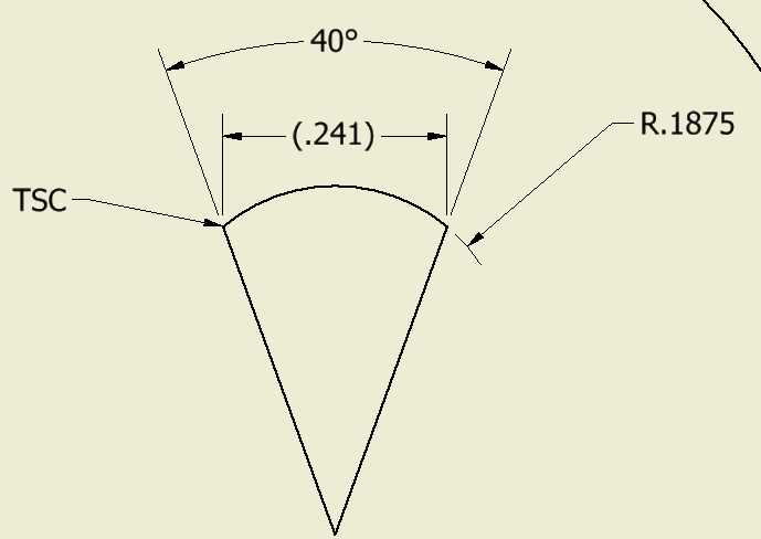

I tried Right-clicking and using Intersection, but I can't seem get the Theoretical sharp Corner pick points on this part.

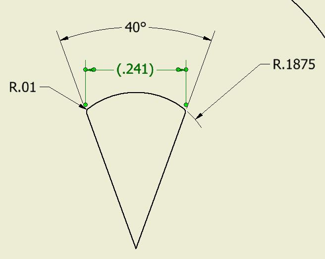

I went back and drew the sketch with sharp corners and then added the Fillets in the Model.
Then I was able and go back and Retrieve the Dimension.
I wonder if there is any other way?
Try using the Node option the ends of the dimensions have a node.
