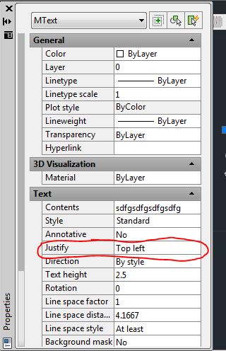

Andrew1979 Posted January 8, 2016 Posted January 8, 2016 As SAFeSTer wrote you need to simply adjust the grip alignment point of the text. To do that, open the properties window by holding down CTRL key and pressing the number 1 key on your keyboard. Select the text In the properties window, scroll down to justify, then in the drop down box, select either Top Left, Middle Left or Bottom Left Quote

RobDraw Posted January 11, 2016 Posted January 11, 2016 If the center justification is absolutely necessary, one could temporarily justify it left so that positioning is easy. Then use the justify command in the right click contextual menu to change the justification back to center without affecting the position of the text. Quote
SAFeSTeR Posted January 11, 2016 Posted January 11, 2016 If the center justification is absolutely necessary, one could temporarily justify it left so that positioning is easy. Then use the justify command in the right click contextual menu to change the justification back to center without affecting the position of the text. I think that would only work if the text width is set to the actual length of the text string. Quote
RobDraw Posted January 11, 2016 Posted January 11, 2016 Did you try it? It works as stated. I got that one from Lynn Allen. Quote
