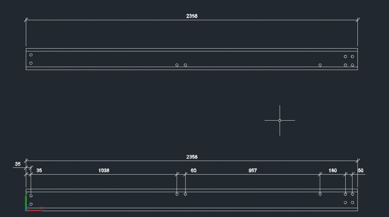

Okay, back again.

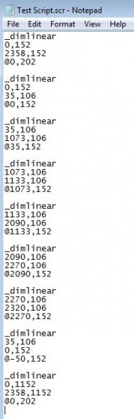

The following are two screen shots of my dimension script and its output.
You'll note at the left side there are two dimensions of 35 on the lower beam. The second higher dimension of 35 is meant to be a vertical dimension and is found in the script as
_dimlinear
35,106
0,152
@-50,152
Appreciate if you could advise me on what do I need to do to get this to be a vertical dimension? it should actually be 46.

Watch the command line prompts, after entering the second extension line origin, autocad prompts you with a list of options - including either horizontal or vertical placement.
BIGAL, many thanks for your suggestions, these have given me something to think about once I feel comfortable with scripting I should then have the time to start looking at Lisp, currently I have no experience with it and really need to remain within the confines of Excel to output scripts which, I might add is coming along nicely.
Steven, again, many thanks for your suggestion, in this instance it is the solution I was looking for - I noticed earlier today the very thing you suggest I then messed around placing the v in my script in various places until I got it to work.
