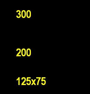

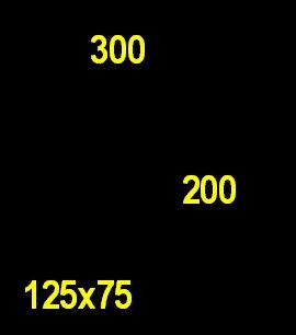

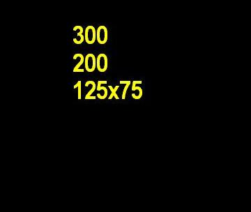

I was wondering if someone could help out editing lee-macs align text lisp so that when the text aligns it doesnt change the position of the text in the 'y' direction. at the moment when I run this it moves all the text in x direction to align which is great but it also moves the text in y direction so they're all equally spaced. if anyone could let me know how to prevent the text from moving in y direction that would be great
would like it to end up looking like the last image below, instead of the 2nd. i've also attached a copy of the lisp file

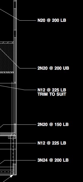

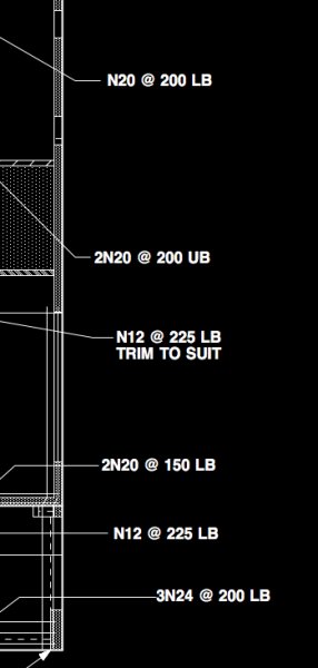

well for me personally i don't think i'd ever need to really use the vertical spacing. i'm mainly after it so i can make drawings alot neater without taking much time. if vertical spacing was changed then it would take to long adjusting all the leaders i think. if the leaders only have to stretch horizontally, then it doesn't take more than a few seconds to do. once the notes shift vertically then obviously leader ends need to move vertically as well as horizontally
if you look at these images you could imagine that if these notes moved vertically too, there would be alot more time/effort required to fix all the leader lines so they meet up with the notes again.
also the vertical position of my text is normally correct i think. I wouldn't want a note calling up reo towards bottom of plan end up being moved right up to the top. that doesn't really make sense.. and with equal vert spacing the notes could seem to blend into 1 giant note so having different spacing makes it bit easier to read i think
I am happy to have it as an option too. Just thought i'd explain how I would be using it
