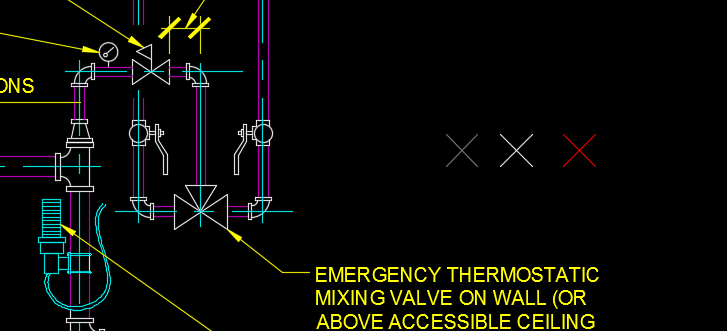

Is there a system variable that controls properties - lineweight points.
On my printouts points to a default width.
I use AutoCAD 2014.

Why point (AutoCAD point) does not change its width?

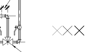

If you are using a .ctb, change the color to red. If you are using a .stb, change the lineweight of the layer. An alternative would be to plot using object lineweights.

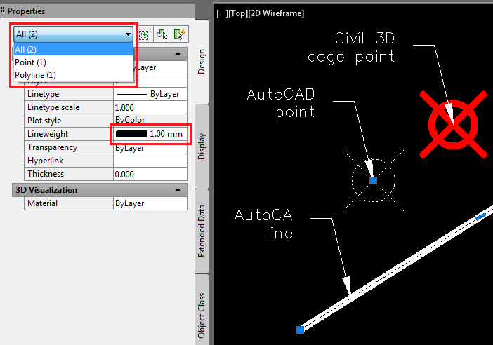

You cannot change the lineweight of an AutoCAD Point. Lineweights also do not affect TrueType fonts or raster images.
You could make a block that looks like a Point.
I must be special because the lineweights of my points respond to changing the color and using a .ctb.
