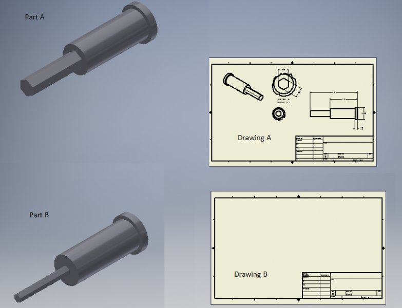

OK I have a drawing "A" that is attached to a part. Part "A"
I know how to save a part with Save As…
When I Do a Save As with the Drawing, I have to delete all of the placed views, place new views and re-dimension everything.
Is there a way to save both the drawing and attached part at once, and keep the connection?
Save Drawing B and then use the Replace Model Reference command in the Manage tab to link to your new Part B.
Or if you are using Vault you can do a Copy Design and it will do it for you.
I knew it! I knew that there had to be a way!
I've asked the question before, and was told that you had to use Vault.
The Replace Model Reference works great.
Thanks
