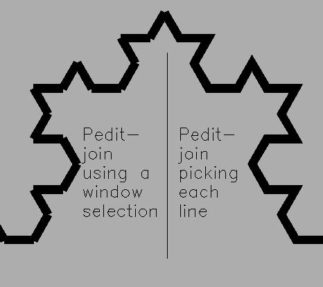

You should be able to have nice corners just by joining all segments with a polyline. There is no need to chamfer or fillet.
Something is going on and upon inspection, as well as the line segments, there are also polylines of zero length at each corner (they must have been created by the other software). If you now use PEDIT, and instead of using a window selection (which would include the corner dots) pick each line segment, then the resulting polyline has nice corners.

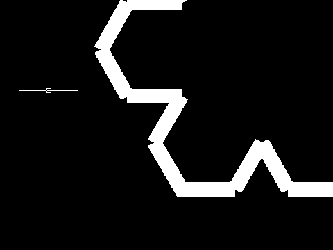

To give rounded corners, make the width of the Polyline zero, and make the Lineweight to be 2

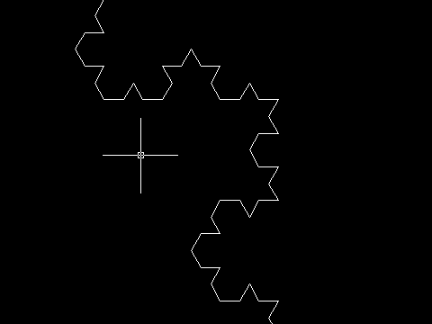

You can do it semi-automatically with APlus plugin (which you can download forum http://www.cadaplus.com
Here's how it works:
Instructions:
1. You can select objects of specified length (zero-length for example) with SELLEN command. Just select object (or objects) of length you wish to select, press Space bar/Enter button to confirm and then specify search area. Objects of specified length will be selected. You may ERASE them (just as I did in example above... however some of nearly zero-lenght lines at right side of a picture were not selected, propably because they have different length)
2. To join objects into polyline use JJ command. Alternatively you may use WELDD command to weld objects into polyline which aren't actually sharing end points (you will be asked for distance to search for possible connections)

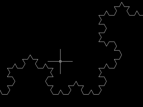

You may also chamfer polyline with CHAPL command:
or FILLET polyline with FPL command:
